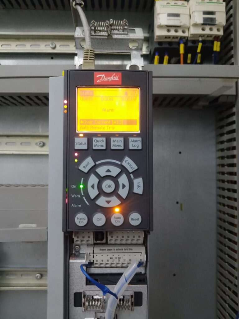

If your Danfoss VLT drive (such as the FC-102, FC-202, or FC-302) has suddenly stopped and the display is flashing Alarm 13, you are dealing with a critical electrical event. This fault, labeled as Overcurrent, is the drive’s primary defense against hardware destruction.
In simple terms, the inverter’s peak current limit has been exceeded. The drive has sensed a surge of electricity so high that it had to shut down in microseconds to prevent the internal IGBTs (transistors) from exploding. Here is a human-made, step-by-step guide to finding the root cause and getting your motor back in motion.

5. The Isolation Test (Rule out the VFD)
If you still can’t find the problem, determine if the drive is internally damaged:
  1. Disconnect the motor cables from the bottom of the Danfoss drive.
  2. Attempt to start the drive without the motor connected.
  3. If Alarm 13 still occurs: The internal power module (IGBT) of the VFD is shorted. The drive must be repaired or replaced.
  4. If the drive runs fine: The problem is definitely in your motor, cables, or mechanical load.
