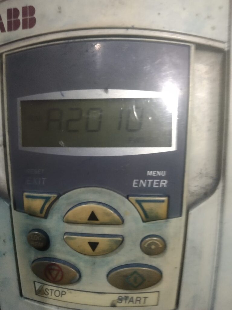

If your ABB ACS550 drive starts displaying Warning A2010, your drive is issuing a serious “yellow light” warning: Motor Temperature is too high.
The ACS550 is constantly calculating the thermal state of your motor. This alarm means your motor is approaching a dangerous heat level. If the temperature continues to rise, the drive will eventually trigger an MOT OVERTEMP fault trip, which will stop your process entirely. Here is how to investigate and fix the root cause.

1. Check for Real Overload
Before changing any settings, verify if the motor is actually hot to the touch:
  • Mechanical Load: Is the driven machine (pump, fan, conveyor) jammed, seized, or running at a load higher than the motor’s rated power?
  • Cooling System: Is the motor fan covered in dust, or is the environment temperature too high? A motor running in a hot room with clogged cooling fins will overheat quickly.
  • Motor Current: Check the actual current being drawn (Monitor Parameter 0103). If it is consistently higher than the motor’s nominal current (9906), the motor is overloaded.
