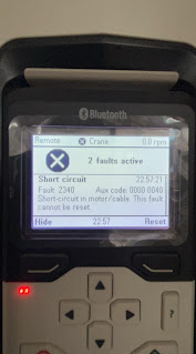

ABB ACS880 Fault 2340 Short Circuit
Staring at Fault 2340 on your ABB ACS880? Learn how to identify motor short circuits, check for cabling errors, and resolve internal drive issues with our expert guide.
When an ABB ACS880 industrial drive stops and flashes Fault 2340 (Short Circuit), it is acting on its most critical protective instinct. This fault indicates that the drive has detected a massive surge of current—far beyond normal operating limits—suggesting a direct electrical short circuit between the output phases or to the ground.
Because this fault protects the internal IGBTs (Insulated Gate Bipolar Transistors) from literal destruction, the drive shuts down in microseconds. This guide provides a systematic, human-made approach to finding the short and getting your system back online safely.

Advanced Diagnostic: The Isolation Test
If you have verified that the motor and cables are perfect, but the drive still trips on 2340 the moment you press Start:
  1. Disconnect the motor cables (U2, V2, W2) from the bottom of the drive entirely.
  2. Attempt to start the drive (it will likely trip on “Motor Phase Loss,” but that is normal).
  3. If Fault 2340 still occurs with NO motor connected: The internal power module (IGBT) of the ACS880 is shorted. The drive unit itself is damaged and needs professional repair or replacement.
