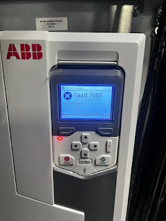

If you are working with an ABB ACS380 machinery drive and the control panel displays Fault 7086, the drive is acting to protect its sensitive internal electronics. This specific code indicates an Analog Input (AI) Overvoltage condition.
The ACS380 is designed with a unique fail-safe: when it detects a voltage spike on an input configured for current (mA), it automatically switches that input to Voltage Mode to prevent the internal shunt resistor from burning out. Here is a human-made guide to help you find the source of the overvoltage and restore your 4-20mA signals.
