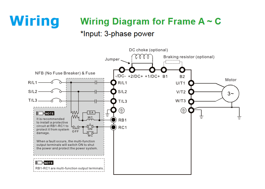

2. Power Circuit Wiring
The main circuit terminals connect the drive to the power source and the motor. Ensure you use the correct wire gauge based on the drive’s rated capacity to prevent overheating.
Delta C2000 VFD power Wiring

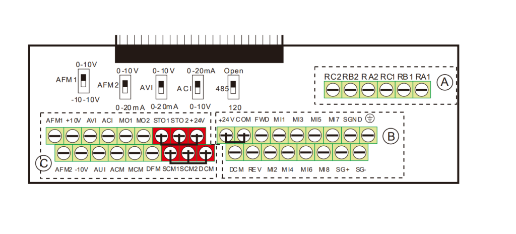

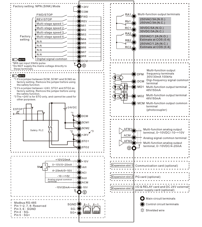

3. Control Circuit Wiring
The C2000 series offers versatile control, including digital inputs (MI), analog inputs, and relay outputs. Many users configure these for 2-wire or 3-wire control, or use a potentiometer for speed reference.
delta c2000 control terminal wiring image
delta c2000 drive control circuit diagram
