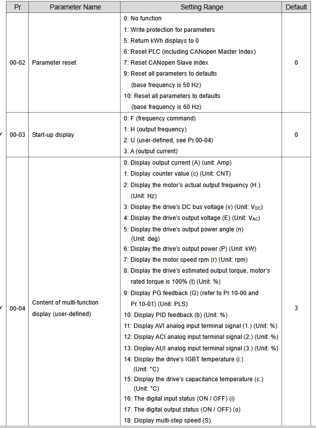

1. Quick Start & Factory Reset
Before programming, it is often helpful to reset the drive to factory defaults to clear any previous configurations.
- 00-02 (Factory Reset): Set to 9 to reset all parameters to factory defaults (50Hz or 60Hz depending on your region).

Delta C2000 VFD Parameter List
Below list show Delta C2000 VFD Parameter List:
| Factory Reset | |||
| 00-02 | 9 | ||
