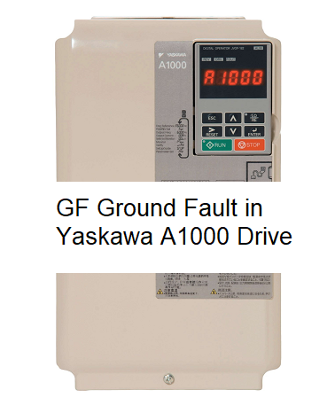

If your Yaskawa A1000 drive has suddenly tripped and is displaying the GF (Ground Fault) code, your system has detected a leakage of current to the earth. In the Yaskawa ecosystem, a GF fault occurs when the current leaking to the ground exceeds 50% of the drive’s rated output current.
This is a critical protective trip. If the drive did not stop, the leakage could lead to electrical fires, destroyed motor windings, or permanent damage to the drive’s internal power module. Here is a human-made guide to help you find the source of the leak and get back to work.
