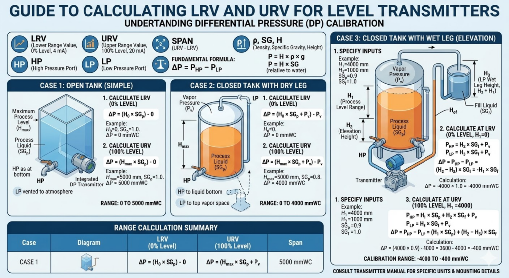

Scenario 1: Open Tank Measurement
This is the easiest scenario. The tank is open to the atmosphere. The transmitter’s HP side is connected to the bottom of the tank, and the LP side is left open to the atmospheric air.
Let’s set up an example:
  • Maximum liquid level to measure (H): 2000 mm
  • Fluid being measured: Water (SG = 1.0)
  • Transmitter is mounted exactly at the bottom tapping point.
Calculating the LRV (0% Level)
When the tank is empty, there is no liquid pressing down on the HP side. The LP side is just sensing atmospheric pressure (which we count as 0 for gauge pressure).
  • HP Pressure = 0 mm × 1.0 = 0 mmH2O
  • LP Pressure = 0 mmH2O
  • LRV = HP – LP = 0 – 0 = 0 mmH2O
Calculating the URV (100% Level)
When the tank is full, there is 2000 mm of water pressing on the HP side.
  • HP Pressure = 2000 mm × 1.0 = 2000 mmH2O
  • URV = HP – LP = 2000 – 0 = 2000 mmH2O
Your calibration range for this transmitter is 0 to 2000 mmH2O.
Scenario 2: Closed Tank with a Dry Leg
When a tank is closed (pressurized), you can’t leave the LP side of the transmitter open to the atmosphere. If you did, the transmitter would measure the tank’s gas pressure plus the liquid level, giving you a falsely high reading.
To fix this, we connect the LP side to the top of the tank using a pipe. If this pipe is empty (filled only with the tank’s gas), it is called a Dry Leg.
The Math: The gas pressure pushes equally on both the liquid (HP side) and the dry leg (LP side). Because DP = HP – LP, the gas pressure cancels itself out entirely! Therefore, the LRV and URV calculations for a dry leg are exactly the same as an open tank.
Scenario 3: Closed Tank with a Wet Leg (Zero Elevation)
This is where things get interesting. Sometimes, the vapor at the top of a closed tank condenses and fills the LP pipe with liquid. To prevent erratic readings, technicians will intentionally fill this LP pipe with a reference fluid (like water or a seal liquid). This is called a Wet Leg.
Because there is a heavy column of liquid constantly pressing down on the Low Pressure (LP) side of the transmitter, the DP reading will actually be negative! This phenomenon is known in instrumentation as Zero Elevation.
  • Measuring Level (H): 2500 mm
  • Tank Fluid: Oil (SG = 0.85)
  • Wet Leg Height (h): 2500 mm (LP tapping is at the very top of the 100% level mark)
  • Wet Leg Fluid: Water (SG = 1.0)
When the tank is empty, there is no oil on the HP side. But the wet leg is still completely full of water pressing on the LP side.
  • HP Pressure = 0 mm × 0.85 = 0 mmH2O
  • LP Pressure = 2500 mm × 1.0 = 2500 mmH2O
  • LRV = HP – LP = 0 – 2500 = -2500 mmH2O
(At 4 mA, your transmitter must be calibrated to -2500 mmH2O).
When the tank is 100% full, you have 2500 mm of oil on the HP side. You still have 2500 mm of water on the LP side.
  • HP Pressure = 2500 mm × 0.85 = 2125 mmH2O
  • URV = HP – LP = 2125 – 2500 = -375 mmH2O
Your calibration range for this wet leg transmitter is -2500 to -375 mmH2O.
