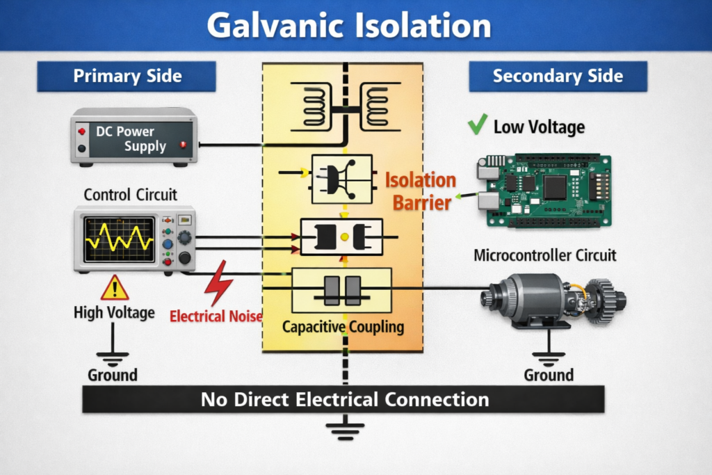

What is Galvanic Isolation?
The term “galvanic” relates to the flow of direct electrical current. “Isolation” means separation. Therefore, galvanic isolation is the practice of separating two electrical circuits so that there is absolutely no direct, physical path for direct current (DC) to flow between them.
Even though the two circuits are physically cut off from one another, they can still exchange information (data signals) or power. They just have to use non-electrical methods—like light, magnetic fields, or electric fields—to bridge the gap.

How Does Galvanic Isolation Work? (The 3 Main Methods)
If we cut the wire between the two circuits, how do we get the signal across the gap? Engineers generally use one of three brilliant techniques:
1. Optical Isolation (Optocouplers)
This is one of the most common methods for isolating digital signals. An optocoupler (or optoisolator) is a small microchip containing two things: a tiny LED light and a photo-receptor.
When Circuit A wants to send a signal, it flashes the LED. On the other side of a microscopic physical gap, the photo-receptor in Circuit B “sees” the light and converts it back into an electrical signal. Because light bridges the gap, no electrical voltage can cross!
2. Magnetic Isolation (Transformers)
This is the oldest and most robust form of isolation, relying on electromagnetic induction. Inside a transformer, there are two coils of wire wrapped around a magnetic core. They do not touch.
When alternating current (AC) flows through the first coil, it creates a magnetic field. This magnetic field reaches across the physical gap and induces a matching voltage in the second coil. Transformers are entirely galvanically isolated, making them perfect for transferring heavy raw power as well as high-speed data.
3. Capacitive Isolation
Capacitive isolators use a rapidly changing electric field to transmit data across a dielectric (insulating) barrier. While they are not used for transferring high power, they are incredibly fast and take up very little space on a circuit board. They are heavily used in modern, high-speed digital communications where optocouplers might be too slow.
