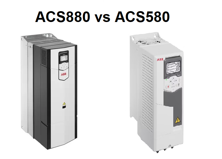

ACS880 vs. ACS580
ACS880 VS ACS580: Which ABB Drive Do You Actually Need?
They look identical from the outside. They both share the same keypad. But under the hood, these two drives are built for completely different worlds. Let’s settle the debate.
If I had a dollar for every time a customer asked me, “Why should I pay more for the ACS880 when the ACS580 has the same kilowatt rating?” I’d probably be retired by now.
It’s a fair question. ABB has standardized their “All-Compatible” drives so well that visually, they are hard to tell apart. However, confusing these two can be a costly mistake. Put an ACS580 on a heavy-duty extruder, and it might trip constantly. Put an ACS880 on a simple fan, and you’ve just wasted 30% of your budget on features you’ll never use.
Here is the no-nonsense comparison to help you pick the right tool for the job.
