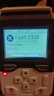

If you are standing in front of an ABB ACS880 and the control panel is flashing Fault 2330, your drive is acting as a high-tech bodyguard. This code stands for Earth Leakage (also known as a ground fault).
In simple terms, the drive has noticed that some of the electricity it’s sending out to the motor isn’t coming back. It’s “leaking” into the ground. To prevent a fire, motor damage, or an electrical shock hazard, the drive trips instantly. Let’s walk through the steps to find the leak and get your production back online.

Step-by-Step Troubleshooting for 2330
1. The “Isolation” Test (The Fastest Fix)
We need to figure out if the problem is the drive or the motor.
  • Power down and lock out the drive.
  • Disconnect the motor wires from the drive terminals (U2, V2, W2).
  • Power the drive back up and try to “Start” it at a low frequency.
  • If 2330 still appears: The drive’s internal hardware is damaged. You may need a repair.
  • If the drive runs fine without the motor: The VFD is healthy! The problem is 100% in your cables or the motor.
