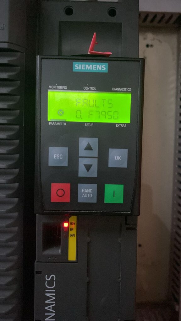

If you are in the middle of commissioning a Siemens SINAMICS G120 drive and the display suddenly trips with Fault F07950, don’t worry—your hardware is likely fine. This fault is the drive’s way of saying: “The motor data you gave me doesn’t make sense, or it’s incomplete.”
In the Siemens ecosystem, F07950 is a “consistency check” failure. The drive performs a mathematical verification of the motor nameplate data you entered. If the numbers contradict the laws of physics or if a critical field is left at zero, the drive will inhibit operation. Here is how to find the error and fix it.
The Secret Weapon: Decoding Fault Value r0949
When F07950 appears, the drive doesn’t just leave you guessing. It provides a diagnostic value in parameter r0949. This value tells you exactly which parameter number is causing the conflict.
  • Example: If r0949 = 304, the drive is telling you there is an issue with p0304 (Motor Rated Voltage).
  • Example: If r0949 = 300, it means p0300 is set to 0 (No Motor), or the motor type is unsupported.

1. Check r0949 Immediately
Navigate to the fault history or the active fault screen and look for the Fault Value (r0949). Note the number. This is the specific parameter you need to investigate.

4. Perform a Re-calculation
If you have corrected the values but the fault persists, set p0340 = 1. This tells the Control Unit to re-calculate the internal motor parameters based on the new data you provided. Often, this “refresh” is required to clear the F07950 consistency error.
