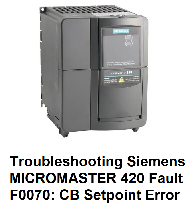

If you are working with a Siemens MICROMASTER 420 (MM420) and your process suddenly stops with Fault F0070, you are dealing with a communication “handshake” failure. While it sounds complex, it’s essentially the drive saying, “I was told to listen to the fieldbus, but my controller has gone silent!”
In this guide, we’ll break down what F0070 means, why the “Telegram Failure Time” is critical, and the exact steps to get your drive talking to your PLC again.
What is Fault F0070?
The F0070 code stands for CB Setpoint Fault. “CB” refers to the Communication Board (usually a Profibus module like the CBP2) mounted on the front of your MM420.
This fault occurs when the drive does not receive a valid setpoint telegram from the PLC (Master) within a specific window of time. To prevent the motor from running “blind” without control, the drive trips F0070 and brings the motor to a stop.
