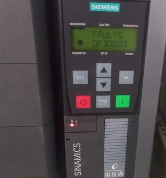

In the world of Variable Frequency Drives (VFDs), the DC link is the heart of the system. It stores energy and converts incoming AC power into a stable DC supply for the motor. When your Siemens SINAMICS G120 drive trips with Fault F30003 (DC Link Undervoltage), it means that this “heart” is not receiving enough power to maintain a stable voltage.
This fault is a critical safety stop. If the drive were to continue operating with unstable DC voltage, it could lead to erratic motor behavior or damage to the drive’s internal components. Here is how to diagnose and fix the power supply issues causing this alarm.
What Triggers Fault F30003?
When the DC link voltage drops below a specific, pre-defined threshold, the G120 triggers this fault. The primary causes are almost always related to the incoming AC power supply:
  • Line Supply Failure: A complete loss of power to the drive.
  • Voltage Sag/Brownout: The incoming supply voltage has dipped below the drive’s permissible range.
  • Phase Loss: One of the three phases of your power supply has been interrupted, causing the drive to lose its ability to maintain a full DC charge.
  • Loose Connections: Corroded or loose terminals at the main circuit breaker, contactor, or drive input terminals (L1, L2, L3).

1. Check the Input Supply Voltage
Before assuming the drive is broken, verify the power quality:
  • Use a digital multimeter to measure the voltage across the input terminals (L1, L2, and L3) on the G120 Power Module.
  • Compare the measured value against the drive’s nameplate specifications. If the voltage is significantly lower than the rated input voltage, the issue lies with your facility’s power transformer or the electrical grid.
2. Inspect for Phase Loss
A missing phase is a classic cause of F30003. Even if the drive shows some voltage, it may not be enough to hold the DC bus steady under load:
  • Measure the voltage between L1-L2, L2-L3, and L1-L3.
  • The readings should be balanced. If one reading is near zero or significantly lower than the others, you have a blown fuse, a tripped circuit breaker, or a faulty contactor upstream.
3. Check Connections
Vibration is the enemy of electrical connections. Inspect the entire power path:
  • Check the terminals on your main disconnect switch, contactors, and the G120 power input terminals.
  • Look for signs of discoloration or “burning,” which indicate high resistance or arcing. Tighten any loose connections found.
