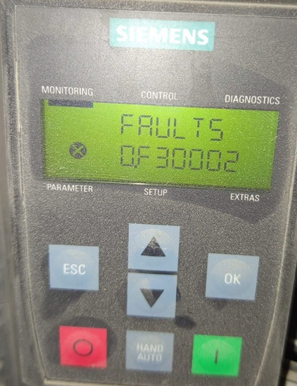

Description: DC Link Overvoltage
On the Siemens SINAMICS G120 and S120 series, Fault F30002 indicates that the DC link voltage has exceeded the maximum allowable threshold. This trip is designed to protect the DC link capacitors and power semiconductors from high-voltage damage.
Primary Causes of F30002
  • Regenerative Energy: The motor is acting as a generator during deceleration (braking too fast), pumping energy back into the drive.
  • High Supply Voltage: The incoming AC line voltage is too high or experiencing transient spikes.
  • Deceleration Ramp Too Short: The drive is trying to stop a high-inertia load faster than the braking system can handle.
  • Braking Resistor Failure: The external braking resistor is disconnected, faulty, or the braking chopper is not functioning.
  • Incorrect Supply Voltage Setting: Parameter p0210 is set incorrectly for the actual line voltage.
